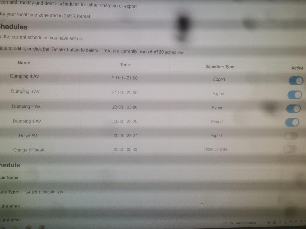

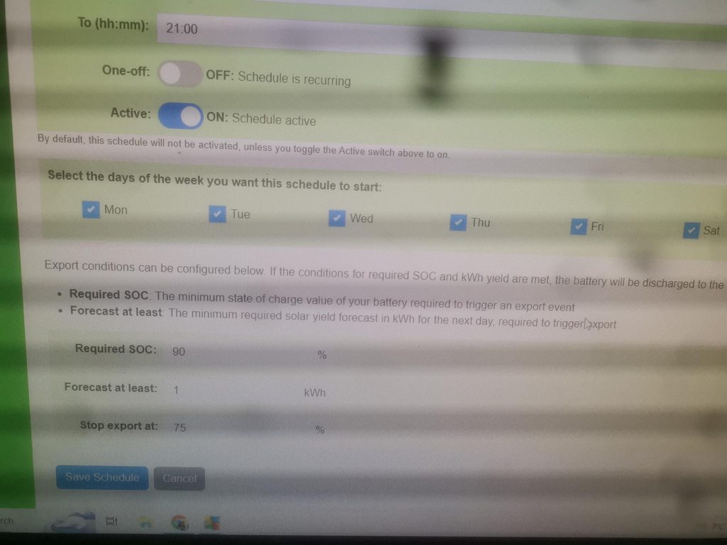

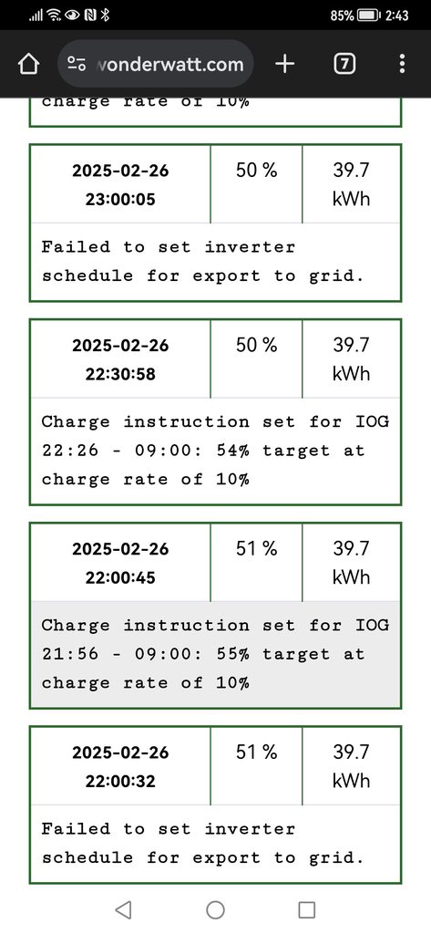

So if I have 100% battery
And it says it going to charge to 50% overnight
The perfect way would to auto dump 50% by 23:30 hrs
But I have tried to set some export to dump 80% by 23:30 and then charge overnight.
But I can't get it to dump as yet
