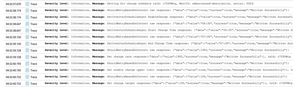

jablad Right, if you do not see mapped charges in the Octopus app, it means Octopus do not control it and when we query the Octopus API, we get no mapped slots, see the logs below:
This is an issue with Ohme chargers, which are currently not integrated with Octopus' API - as in, Octopus controlling the IOG charges.
    admin I see, so do Octopus tell Ohme and it’s Ohme that control the charges then?
      jablad Not 100% sure how it works, but I think Ohme control it yeah. And send details to Octopus after the fact.
      All we know is that if you do not see mapped charges in the Octopus app, we don't know which charges are the adhoc cheap ones.
