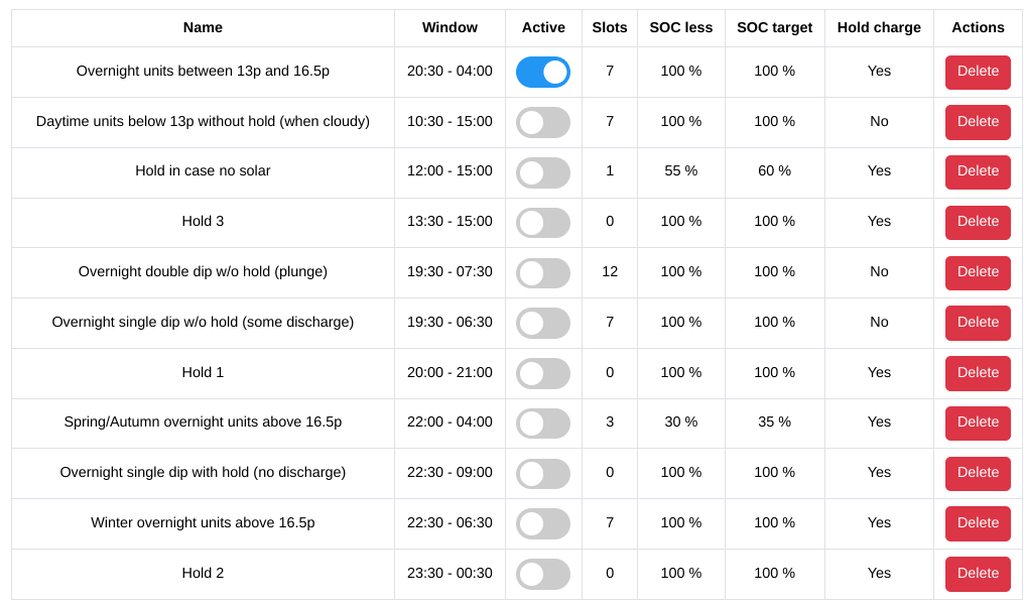

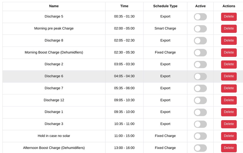

Pedro1972uk These are mine but I suspect they are fine-tuned to my setup. Each day I adjust the time slots depending on the slot prices and choose the schedule most appropriate to time of year and expected solar for the next day. Certainly you can start from these in finding your own that work well.
I can export and get paid 16.5p/kW (Eon Next) so I have 2 thresholds of 16.5p and 13p (=16.5 x 80% battery losses). I charge the batteries below 13p, hold the charge between 13 and 16.5p and use the batteries above 16.5p. If the Agile prices are below 13p I try to fit in as many charge/discharge cycles as I can to maximise my exports. If they are above 13p I try to get away with the fewest charge slots anticipating the following days solar.
4.8kWp array (17 panels), SW facing, 8kWh usable battery storage. Typical house load 15kWh/day.
