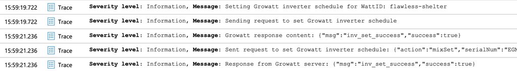

Can't export between 4pm-7pm. I thought i had set up that the battery would export between 4pm-7pm. Export till battery gets to 40%. Only if the battery has more than 40% SOC. I made this setting on my wonderwat profile but it does not work. Have I got the wrong setting?
Dvanced setting/Miscellaneous setting is switched on.
Schedules/export conditions schedule required SOC 40%, forecast at least 8 Kwh, stop export at 35%.

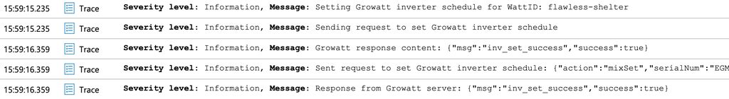

    Duncan57b Looks fine, we succesfully sent a discharge schedule instruction to the Growatt API at 16:00 yesterday, see our logs below:
      admin it did not work today? Why can't I discharge my battery and solar pv to the top 3.6 kwh discharge to the grid?
        Duncan57b Can you set it through the ShineApp at all? We basically use the same underlying calls.
        Are you on a DNO export restriction by any chance?
          admin no, i am on not on a restriction. I have export to 3.6 Kwh. Today my battery is not exporting. Between 4pm and 7pm.
            Duncan57b We send the instruction and it was successfully received by Growatt.
