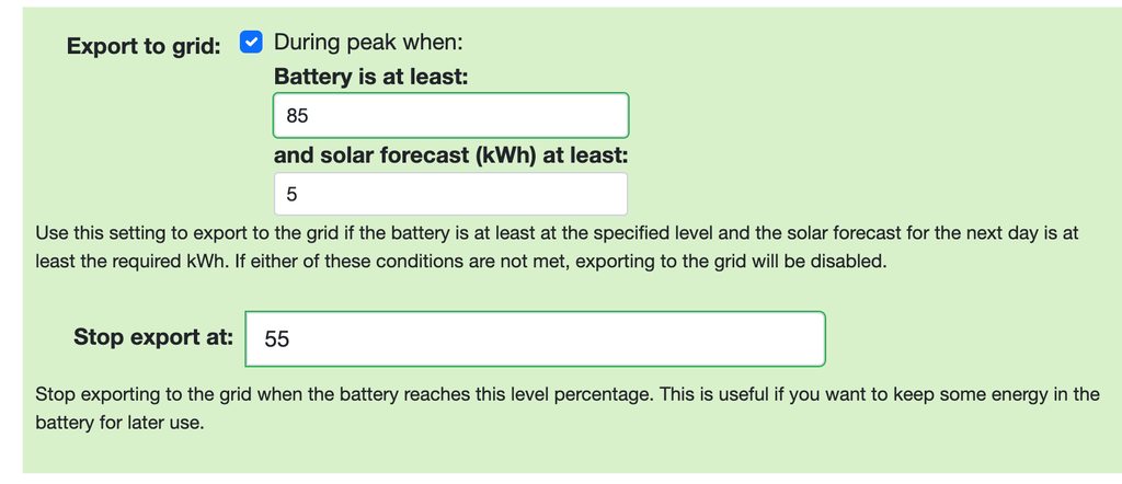

This way the export is maximised until the battery reaches your set cut-off point (say 40%), then the battery stops exporting to the grid. But the solar still continues to export to the grid the whole peak period until peak period ends.
Priorities to run the house during peak hours to maximise full export to the grid.
The solar has priority to run the house during the peak hours until the battery has reached it's set cut-off point (say 40%).
When battery has reached its cut off point (say 40%), and has stopped exporting to the grid, then the priority shifts to the Battery to run the house, while the solar continues to export to the grid.
At the end of peak hours then normal ECO is resumed and the battery can then be charged by solar again.
