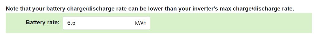

        This might be an old engineer's nitty-gritty. But should it be kW and not kWh? Effect, not energy?

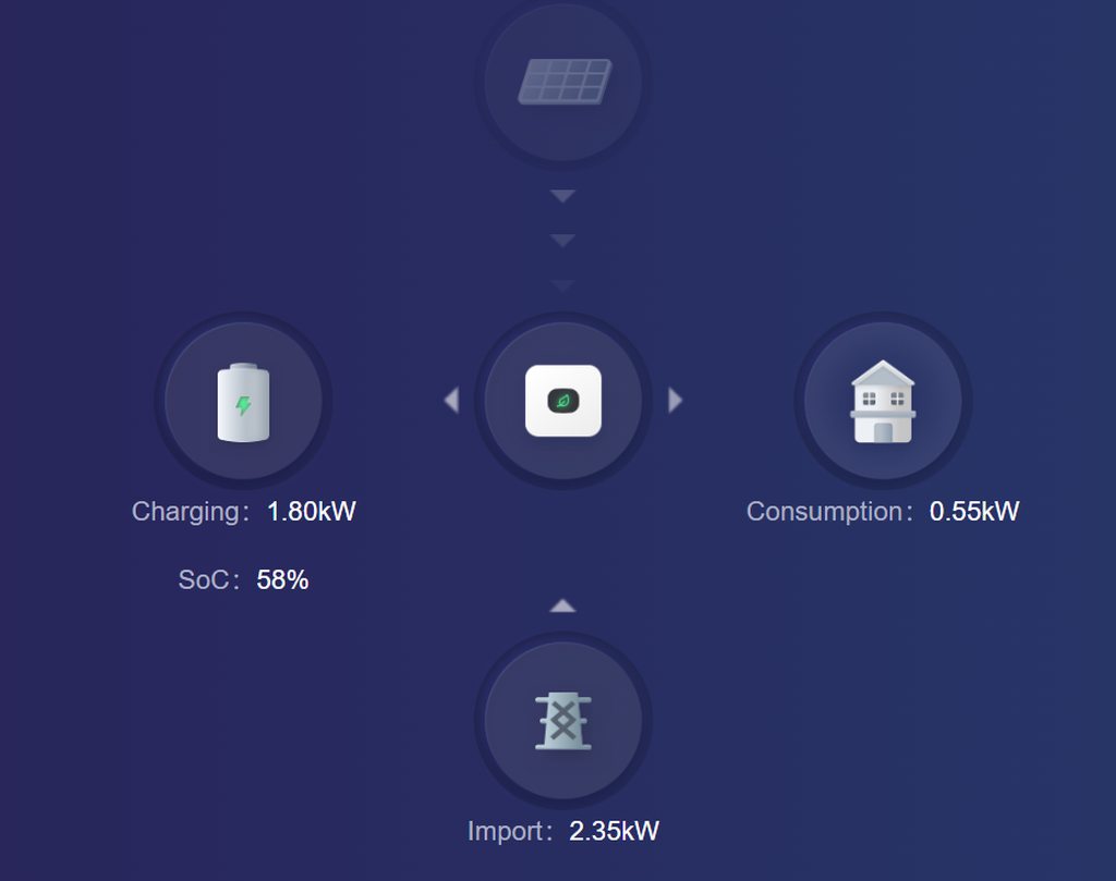

          admin There may be another issue. Schedule has just started and states 18% charge power. Growatt charges with 1.8 kW. This means that 100% is 10kW. And I entered 6.5kW in [Battery rate]. It seems as if WW does not care and still calculate with 10kW. With this charge rate, battery will be full in little over 3 hours , not counting for losses.
            perfrank So this goes back to my question before. When you isssue a 50% charge rate on your inverter, what does your battery charge at?
            I think your inverter charges at a percentage of its max rate and does not take into account the battery max charge.
            Which is why my suggestion before was to introduce a separate inverter max charge as well in Advanced settings, so we can recalculate the correct percentage in accordance with your battery/inverter ratio.
              When charging 50% it charges with 5.02 kW.
              5 kW is 50% of 10 kW, so inverter uses its max rate for percentage calculation.

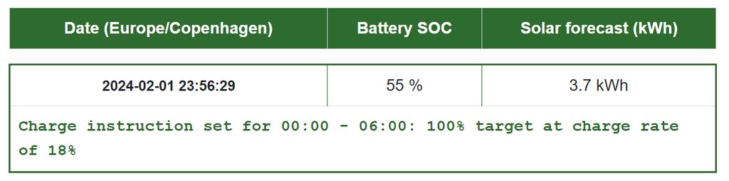

              I might have misunderstand how the calculation in WW works and why numbers come out as they do. What I want is that the calculated charge is distributed over the available periode. With upper numbers as example):
              Battery capacity times (1 - SOC) divided by hours in period.
              12.8 * (1-55/100) / 6 = 0.96 kW. Which is 9.6% of the 10kW. However, WW have calculated todays charge rate to 18%, which means, that charge has finished in 3.2 hours. I expected the charge to be distributed over all 6 hours. How can I achieve this?
