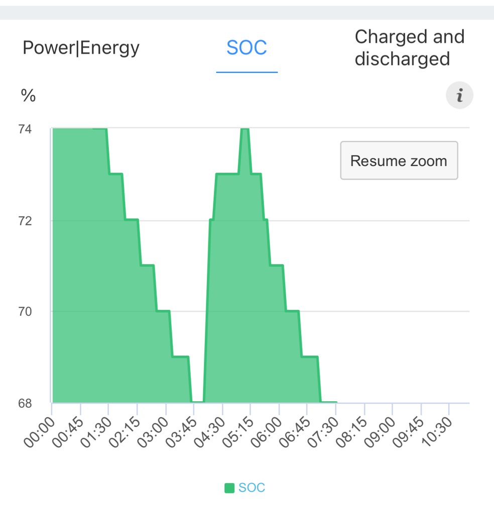

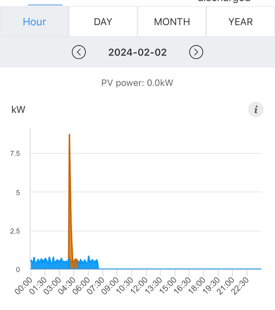

      I had put the battery max setting to 3kW , to give it a try.
      Looking at my import graph it seems charge at full 100% for about 30 min, but stop at the correct target level (it just hit SOC 74%)
      So SOC stop setting seems to work, but not charging rate

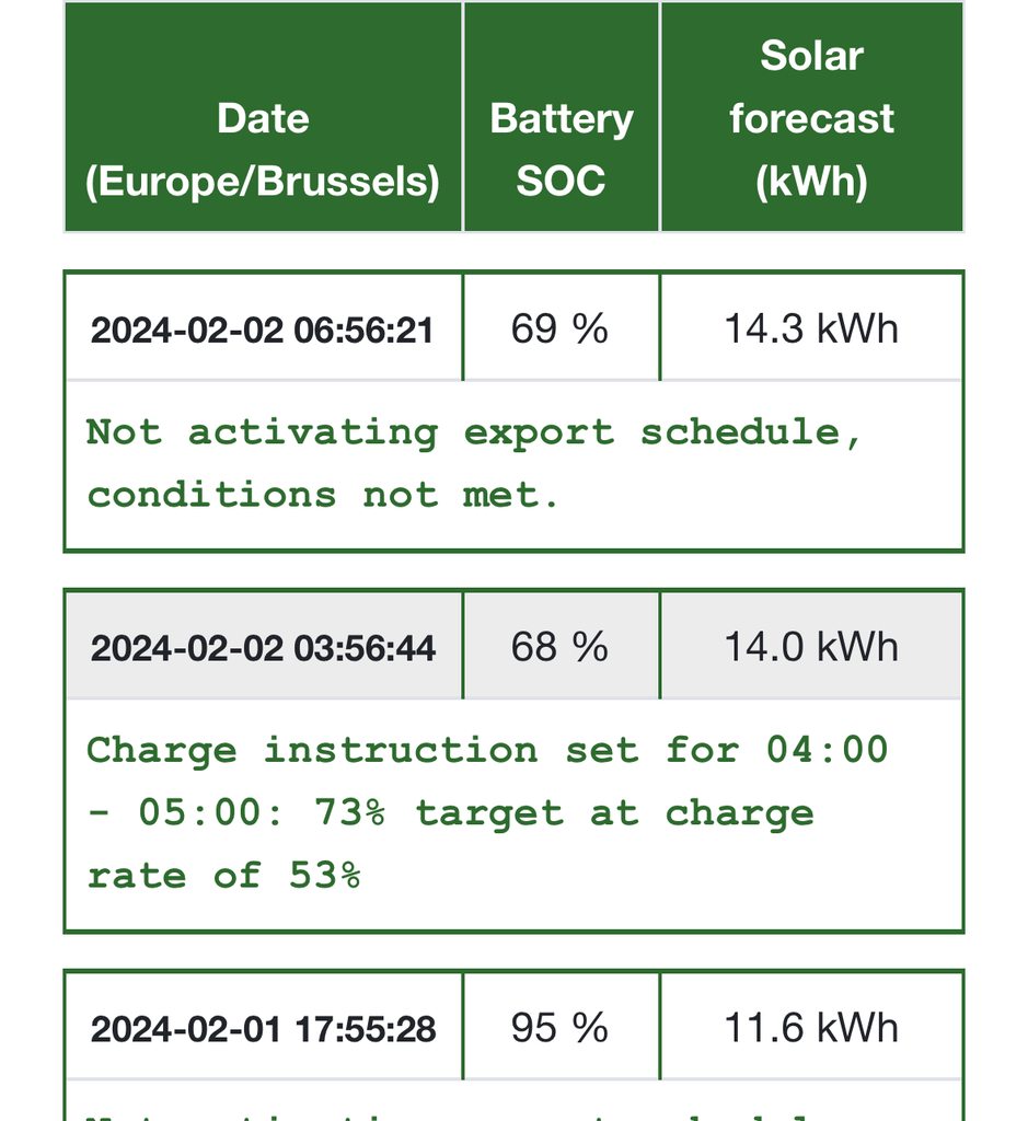

                  admin OK , checked it in a trial schedule. The schedules say charge to 37% with charge rate 43% . These settings are both correctly visible on the server and the time slot (3) is correctly set to grid first. We have already seen it will re-set back to 100% for SOC stop and charge rate after the session, so the integration works correctly
                  I also see it charging with 4.1 kW which seems in line with the 43% (9kW inverter)
                  But for the calculation, I think there are some issues there:
                  the schedule calculated a 43% charge rate (= approx. 4,1 kW in my case) with the max battery rate set to 3 kW in advanced setting (Smart battery charge enabled)
                  And it calculated a charge rate of 43% to go from SOC 35% to target SOC 37% (2% increase which is 0,6 kWh in my case) for the set time period of 30 minutes .
                  (In my logic is should have charged with 1.2 kW to reach the target in the 30min slot ., so 1.2kW /9kW * 100% = 13% charge rate
                  With the calculation putting a max for the battery charge rate setting. In my case I put 3kW as battery max charge =33% max charge rate )
                  You want to share your calculation logic or do you want it to work different as I describe perhaps? ( and “ Krustydad” I believe)
