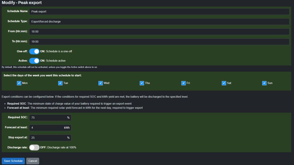

Next, you want to create a peak export schedule. This is how you're going to maximise returns, something like this:
You may want to adjust these settings, depending on your evening consumption.
It's import to leave enough in your batteries to last at least until 2am.
