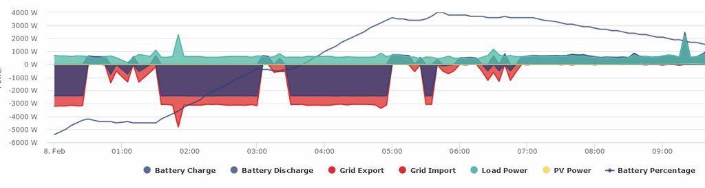

For Giv users, the hold-charge has now been switched out for actual battery pause functionality. Just deployed, version 380.
admin Seems to be better. Last nights results...

Yeah, it's effectively the same as using the Pause button on the Giv app. It's to make sure that during the hold charge periods, there isn't any fluctuation of 100W here and there, which does happen if you're keep AC charge target to current SOC.
- Edited
admin it's effectively the same as using the Pause button on the Giv app
The app pause button pauses charging and discharging but for the WW hold feature, you just want to pause discharging so you could just change the discharge settings and leave the charge settings alone.
It's interesting that despite the discharge setting being zero, there was still some discharging (a few Watts). Couldn't test the EV bit because the EV charge was during selected slots only. One night it will happen..
