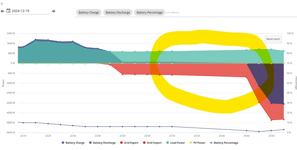

              Hi @admin , not been on for a while because, well everything has just been working fine and I've had zero issues, until last night.
              WW failed to set IOG (23:30-05:30) charging.
              Nothing in the WW activity log, so I checked Giv inverter log and nothing set by WW.
              I'd spotted it last night, so I set the times myself.
              This morning there are the usual instructions from WW at 05:30 to reset.
              I thought at first I must have paused the schedules by mistake, but nope, I've only paused user schedules as intended.

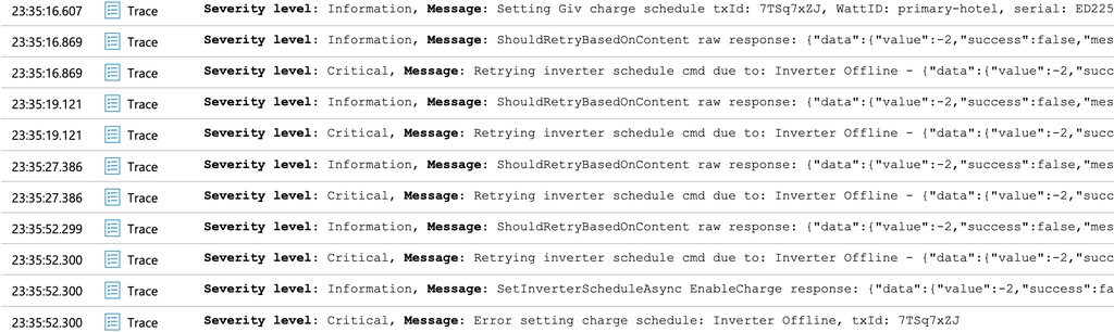

              On checking further, it appears my inverter was offline just at the critical moment...
              Could you just check the logs at your end and confirm that instructions were set but not received, due to inverter offline, please?

                MrMessy I had an inverter offline error at 1.30am and missed one of the Agile 30 minute slots. I wonder if GE were doing something as inverter offline is now quite rare after changes I made earlier in the year.
                MrMessy Yep, indeed, Inverter Offline:
