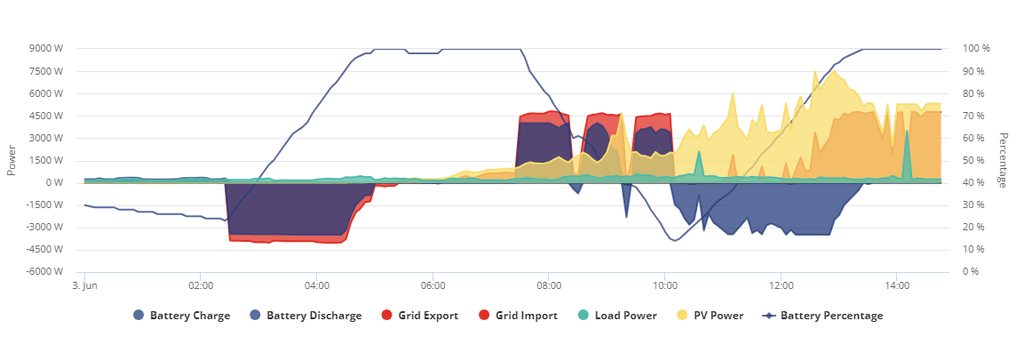

However I have one more issue. It seems after the discharge schedule is completed the systems enables Eco mode again. But in this case the batteries will immediately start charging at full capacity again. However when my solar production starts exceeding my inverter capacity (abt. 5.3 kW in my case). I attach the curves of todays session for your info. You can see the battery starts charging again from 10 am whilst nothing is exported to the grid. As soon as the battery reaches full charge (after 1 pm) the solar production drops to the maximum inverter capacity.
I only want to send the excess DC to my battery, whilst any AC produced should go to the home consumers and any excess thereoff I want to export to the grid. In this way I maximise the time I can keep storing the excess DC from the solar panels.
I found that if I manually disable Eco mode in the GivEnergy remote control the charging will be taking surplus solar DC power only, which is exactly what I'm trying to achieve.
Any chance to automate this? If I could just add an item in the schedule that switches off the eco mode that would do the trick.
