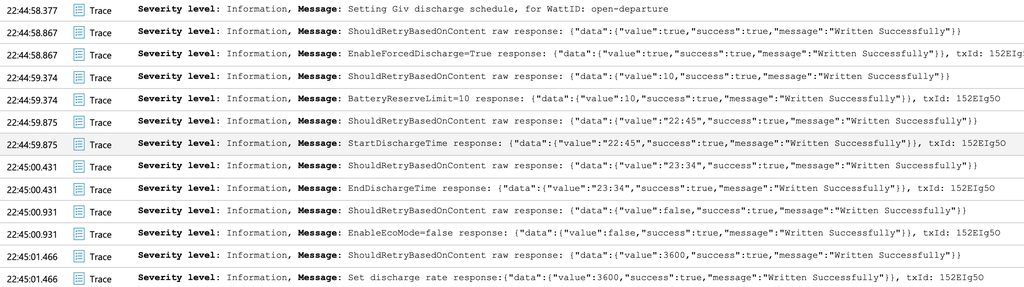

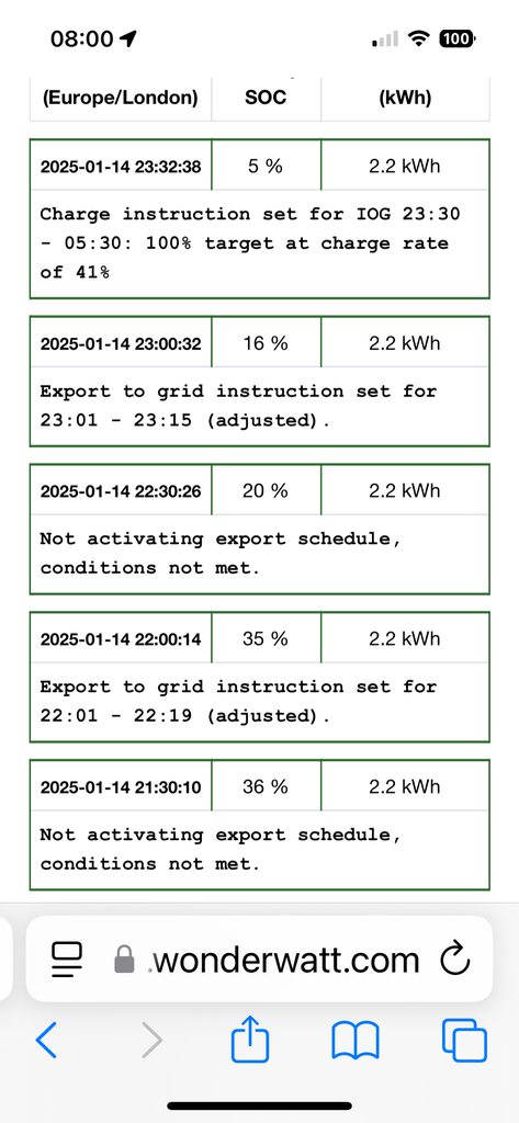

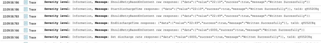

...some other exports do however seem to have failed at our end.

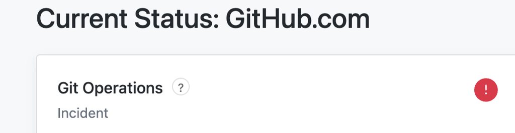

And can't push temp fix currently because of:
ðŸ˜
Update: Looks like some of the battery reserve read cmds for Giv inverters failed in some cases, which led to some exports not being run. We've put a fix in that shouldn't stop the discharge from going ahead if the read fails.
