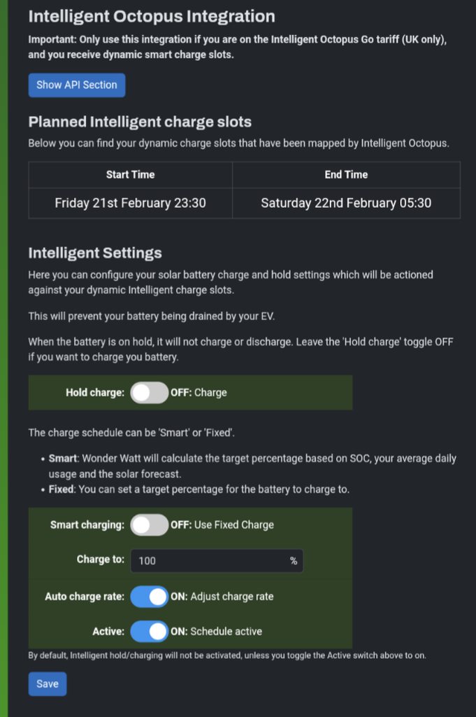

I tried again this evening and this time the car charged bu the home battery did not. But the batteries discharged into the car. I find the settings hard to follow. Which toggle to use and what is on or off. There doesn't seem to be a step by step user guide for newbies. I can't see that I'd be prepared to pay for WW unless I can fathom how it works in the next 10 days.

stevek54 Yesterday you had an IOG slot at 20:30 to 21:00 and at 21:56 through to 5:30. However, at that point you still had "Hold" set, so it wasn't charging. You have since set it to charge, so it will from now on.
Additionally, when you get these charge schedules from Octopus earlier than 23:30 in the evening, your export instruction at 22:30-23:00 disrupts those IOG adhoc charges.

I see, from other replies, it looks like you have this sorted but, just in case, I have this...
Also, make sure you have no schedules set in the Zappi or EV.
If your EV has trouble waking up with split schedules from octopus, check you have "plugin charge" set to on in the Zappi head unit.
admin Additionally, when you get these charge schedules from Octopus earlier than 23:30 in the evening, your export instruction at 22:30-23:00 disrupts those IOG adhoc charges.

admin I’ve deleted my evening export charges in the hope that this sorts it for me as think it has been causing a conflict when already exporting it continues to drain the battery to charge the car.
Hoping I’ve now got all the settings right but don’t need to charge the car today, so will see tomorrow.
