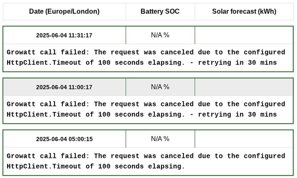

webmink The last couple of attempts by WW to set a charge schedule on my Growatt inverter have resulted in a timeout. The log says: Growatt call failed: The request was canceled due to the configured HttpClient.Timeout of 100 seconds elapsing I don't see any other issues with Growatt's web site or my system. Anyone else seeing similar?
admin webmink We're seeing a significant spike of these, especially yesterday and today. Will investigate. Looks like issues at their end. We also have plenty of Growatt users that have successful instructions.

admin webmink I wonder if this is specifically happening for Agile, and perhaps us firing multiple calls to the Growatt API for a huge number of users is simply being throttled. We'll have a think.
webmink admin perhaps us firing multiple calls to the Growatt API for a huge number of users is simply being throttled. That's certainly possible - do you have a choice of servers like users do for web login? However, the last couple of nights I have (unusually) been awake around 4am and I have noticed that logins to the Growatt web page have been down. Maybe they are just have some problems with their production systems?
admin webmink Maybe they are just have some problems with their production systems? Yep, I think that's exactly what it is, an overload of requests to their login/auth servers.

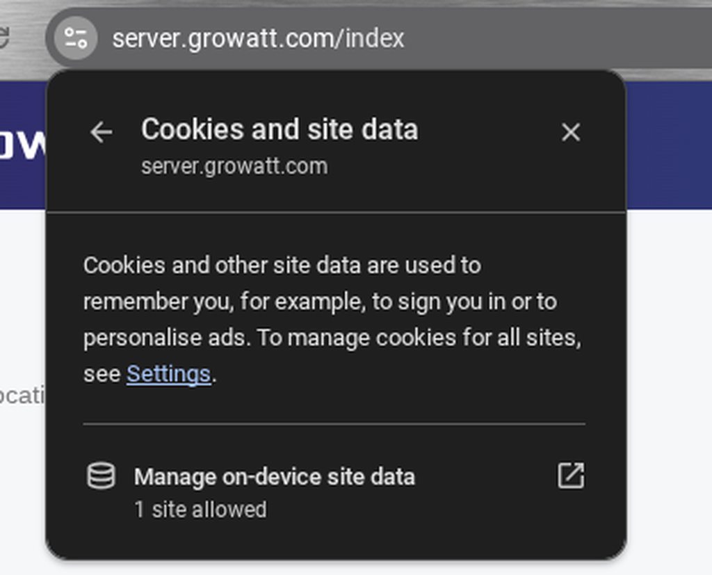

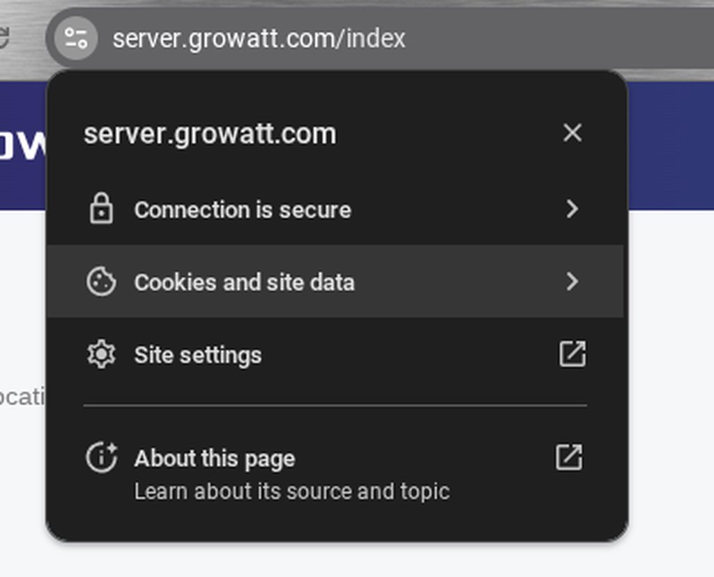

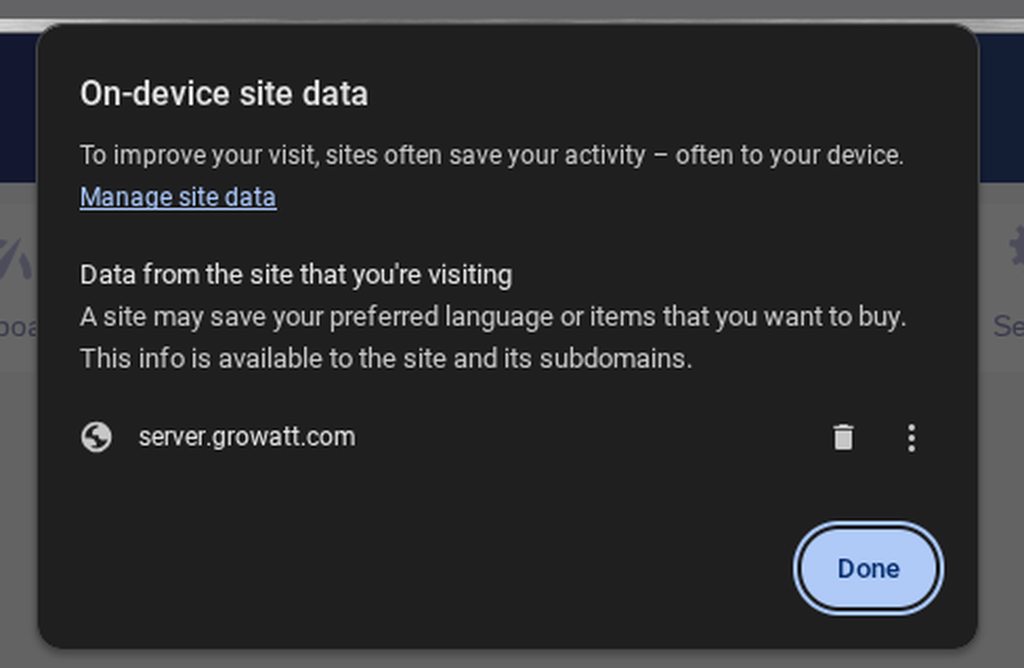

webmink spencerralph If you are using Chrome, click the icon before the URLto get this: Then click "Cookies and site data" to get this: Then click "Manage on-device site data" to get this: Finally click the bin icon to delete the currently stored data.
