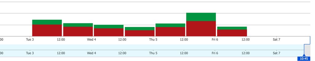

admin We made some changes around client connection contention and retry policy synchronisation, which hopefully will alleviate some of the Timeout issues you've been seeing. Update: Looks like this has been successful. Red bars are Timeout errors.
