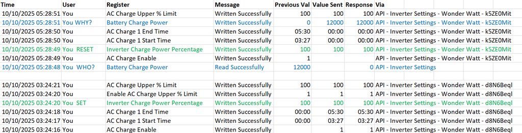

Standard Charge Schedule 03:27 - 05:30 Charge Rate OFF (100%)
WW Sends Inverter Charge Power Percentage at start
WW Sends Inverter Charge Power Percentage at End
WW Also Sends Battery Charge Power Command at End
Charge Schedules are Fine see below, I don't understand the "Battery Charge Power" Read (Not Me), and we continue to Reset the "Battery Charge Power" value "which is not relevant to Dual AIO's and isn't getting set by WW in this instance anyway.

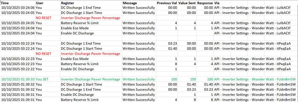

Discharge Schedule 01:40 - 03:25 Discharge Rate ON (ADV Rate)
WW Adjusted to 01:40 - 03:23
WW Sends Inverter Discharge Power Percentage at start
WW Sends 2 Sets of End Commands NO "Inverter Discharge Power Percentage" Commands are Sent for either the original Slot or for the Adjusted Slot End.

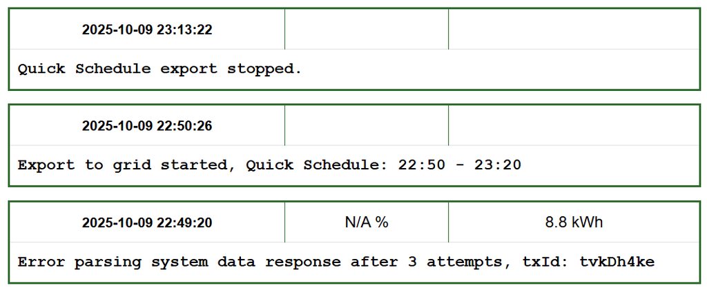

Last night once again I had a (Standard Schedule) parsing error from the GE API, when WW attempted to execute it ( @admin is currently addressing this GE shortcoming). Therefore, (last night's) scenario, at Duplada HQ, was slightly different, unlike my (Alert 5) situation of the previous evening, (WW Home page Open and Ready to Rock). We had retired early for the evening (Hobbit Syndrome), I know its early right?, but I have to be up bright and early, to report back here (very sad). I know, its no excuse that it took a lengthy 66 seconds, from receiving the WW WhatsApp message, to executing a manual 30 minute discharge response. You have to understand that there were mitigating circumstances (NDA Doesn't Permit me....). Now I accept that a 66 second response time is a somewhat tardy effort, and I can assure you all, that I am committed to maintaining times, close to, if not exceeding, my world class 34 seconds of the previous evening. However,.........

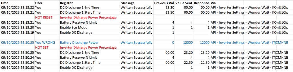

Discharge Scheduled Time Slot 22:50 - 22:20
WW 2025-10-09 22:49:24 Error parsing system data response after 3 attempts, txId: tvkDh4ke
WW Sends WhatsApp Alert 2025-10-09 22:49:24 An error has occurred when trying to send a export to grid instruction to your inverter, please check your Wonder Watt activity log.
202-10-09 22:49:30 Operator Duplada (ME) Stops household proceedings, Fumbles to find phone, Reads WW Message, Navigates to WW Home Page, and Executes a Quick Discharge.
Operator Duplada (ME) Executes a Quick 30 Minute Discharge 2025-10-09 22:50:26
Then, because the house Batteries were low, Operator Duplada (ME) had to watch, and manually stop, said manual discharge early on reaching 8% SOC (what a pain π£ ). A premature π to the Quick Discharge, and also the Night's other Proceedings π’
2025-10-09 23:13:12 Quick export schedule stopped.
WW Sends NO Inverter Discharge Power Command at Start
WW Sends NO Inverter Discharge Power Command at End
