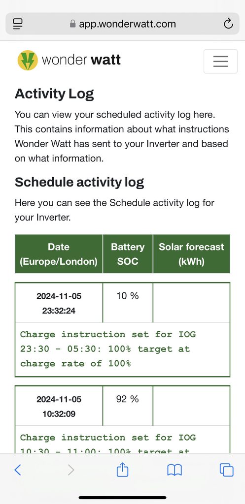

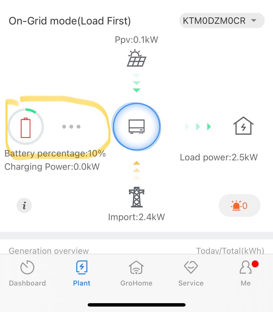

                      Hello, @admin my Growatt battery failed to charge over night. I have checked the logs and there’s no history for last night.
                      Is there a way to check to see why?
                      Many thanks
                        Ardvarky What is your WattID please?
                        Odd - we can't find any entry in the logs for this. Schedules weren't paused I take it?
