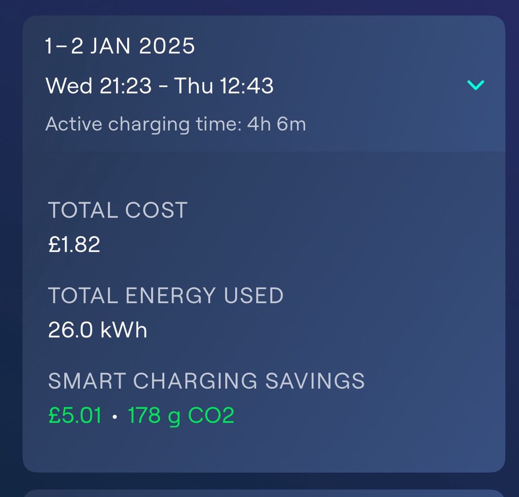

                    unwelcome-dream Happened again today. WW sent IOG charge instructions when the car was not plugged in. Can someone look at my logs and see what’s going on don’t want to be charged full whack for this.
                      DavrosMcT You had a valid charge until 16:00, and then this was updated to a valid IOG charge to 17:00. All mapped via the IOG dispatch slots.
