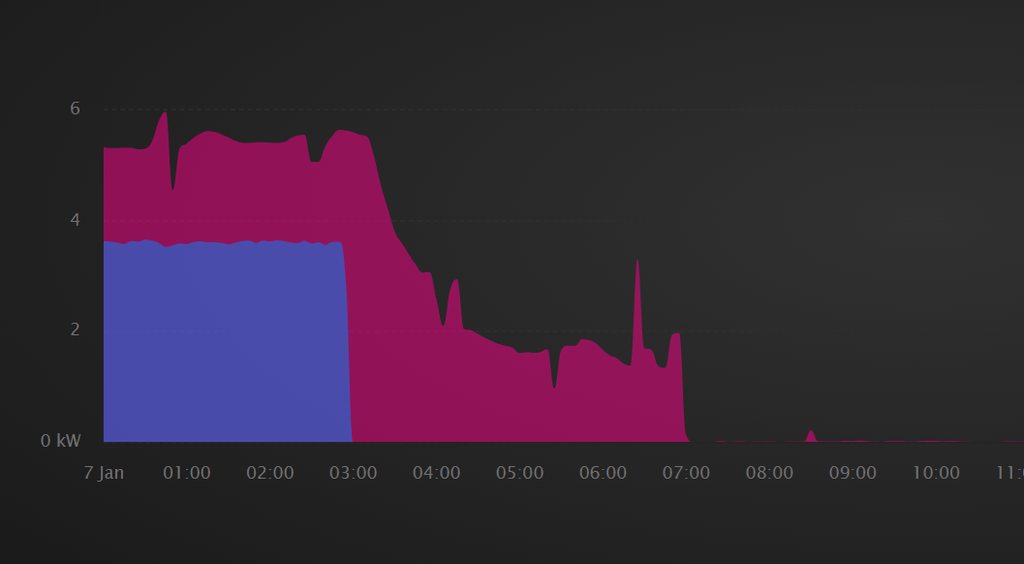

unwelcome-dream Today was charging the battery and thought there was a charge from 11:58 when the car was not plugged in. Also Mrs leaves the car plugged in a lot and it seems to map a slot even when the car is full.

unwelcome-dream Happened again today. WW sent IOG charge instructions when the car was not plugged in. Can someone look at my logs and see what’s going on don’t want to be charged full whack for this.
This is the only charge slot I have had this year on the ohme app?
DavrosMcT Do you see mapped charges in your Octopus app when you plug-in? We get the smart slots from Octopus via their API.
I was under the impression that Ohme charging wasn't compatible yet, but clearly we are getting intelligent EV charge slots from the Octopus API for your account details.
