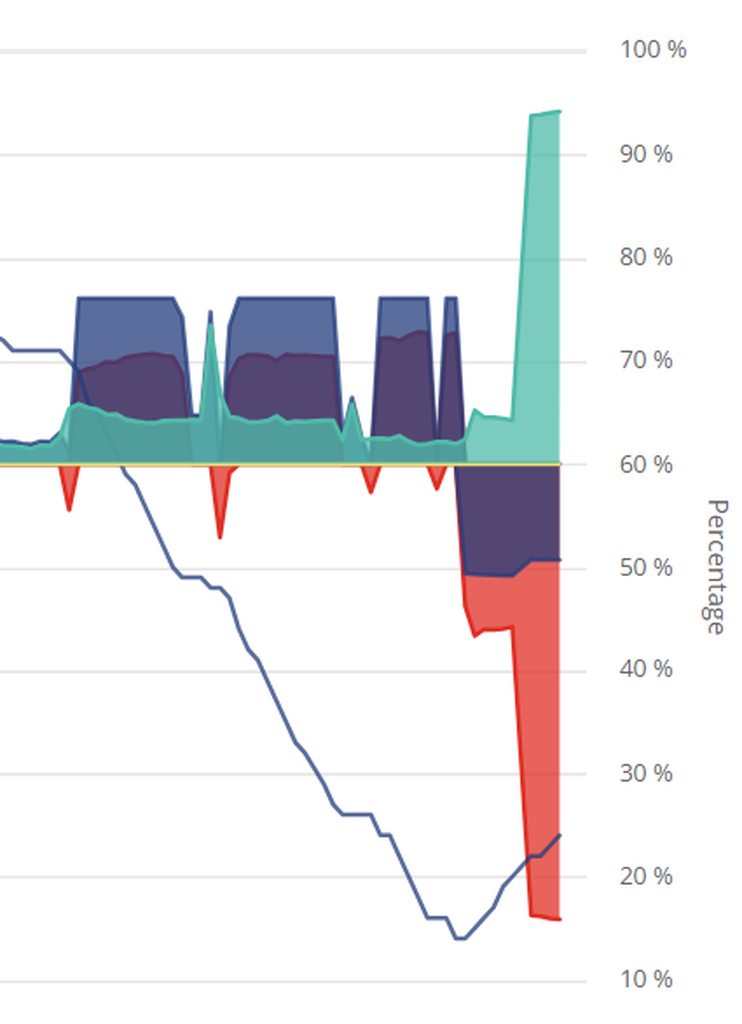

Here's one of mine, where the smart charge started at 23:00 (even though the EV didn't actually start charging until 23:29), but you can see it cut short the discharge, which was timed to finish at 23:25

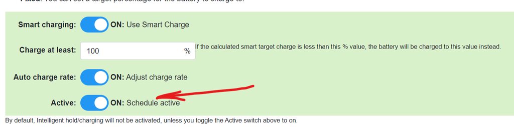

Also, make sure you have this set, otherwise it will dump your battery in to the EV, which I assume you don't want.
