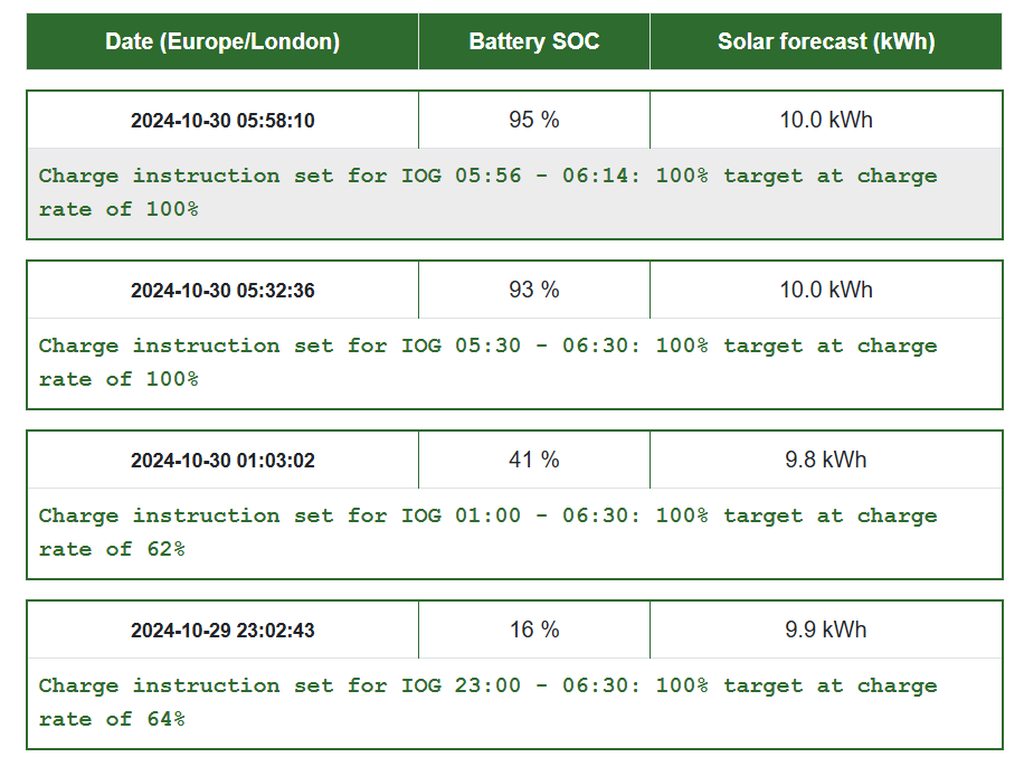

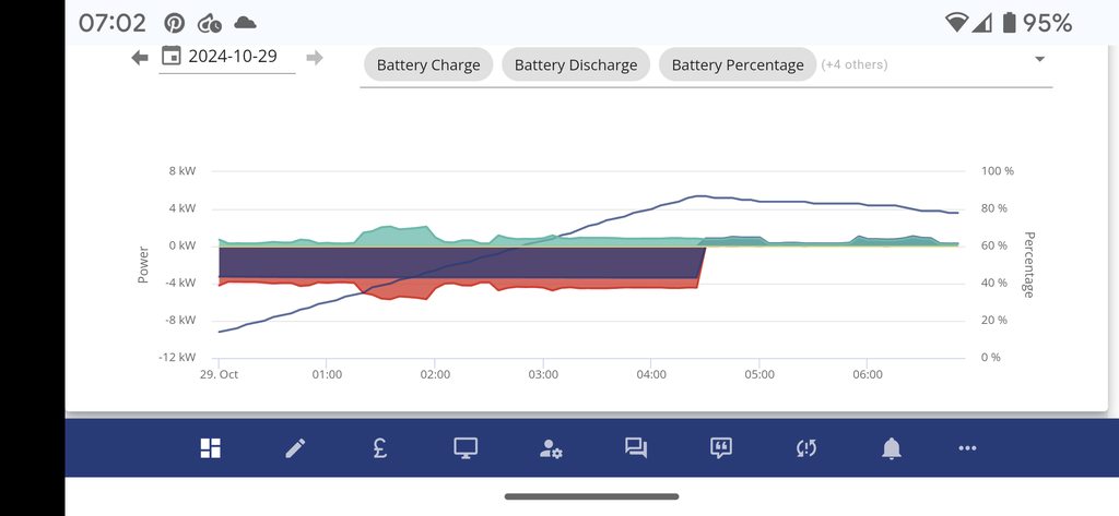

admin Well, that seemed to go according to plan. I had paused my "IOG Fix" schedule, to see the effect, but I'll put it back tonight until we've confirmed the 04:30 issue is fixed.

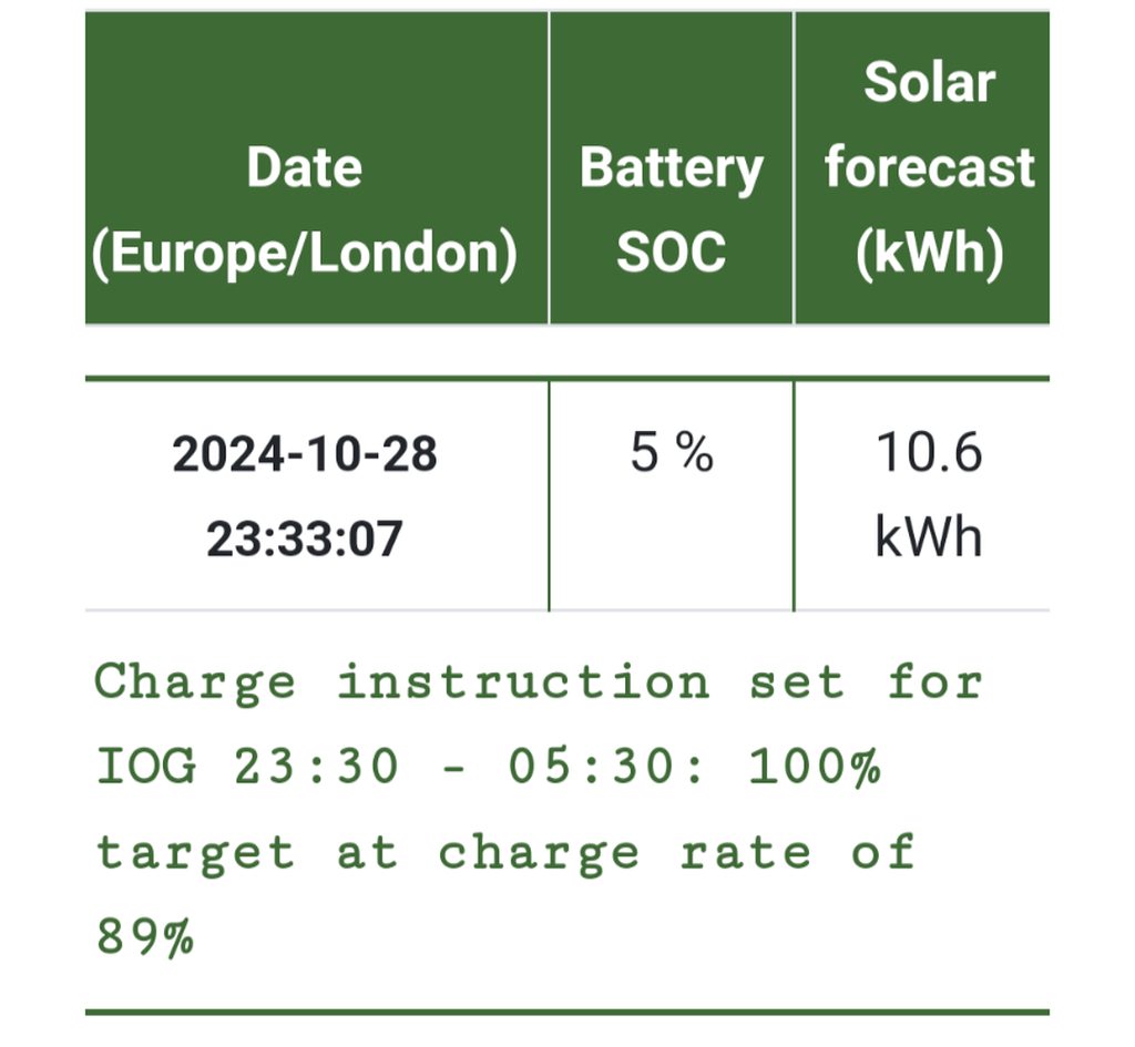

WW clearly reacting to some overnight changes from Octopus that I didn't see ...
... and no unexpected stopping at 04:30 ...

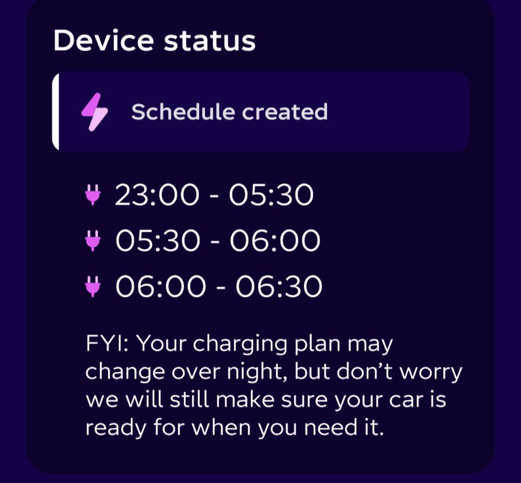

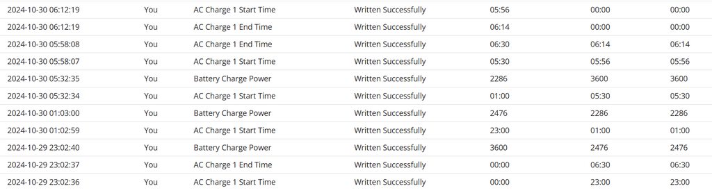

I still haven't figured out what happens to Kraken at 05:56 though. I've seen more FB posts with schedules changing at the same point, but not sufficient to identify any correlation yet. There's the usual do-gooders saying that's just how IOG works, and I'm fine with Octopus adjusting schedules on the fly, but there must be some significance to that exact time and it's bugging me.
Anyway, rambling a bit now. Keep up the good work.
P.S. Nearly forgot ...
It's only a very minor niggle but, the last change from Octopus put the end time at 06:14, as did WW. However, it would still be cheap rate until 06:30. Is it possible to forward set the time to suit?
