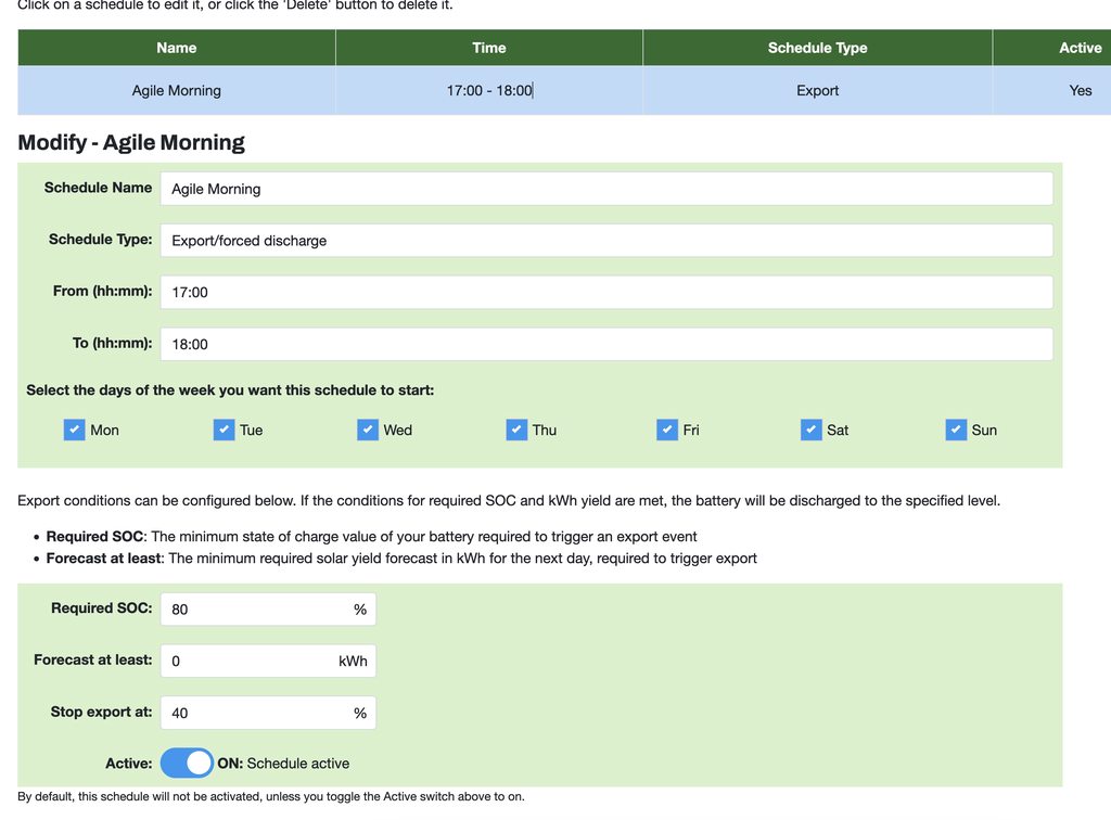

            I've just opted in to today's Savin Session with Octopus. It will be my first export using the WW scheduler
              admin Remember you must have a minute between off and on times. End 17:00 and then export at 17:01 or it might not work. This bug was pointed out in another post somewhere.
                Gazzagreen You're right, this was an issue for Giv.
                This might actually be OK for Growatt, but yeah, good point, better to use a min margin either side, will change it now, don't want Growatt failing on my export session!
                So do you get more money exporting in the saving hour?
                  Gazzagreen Yep - as the delta will be calculated between what your regular use is in that time slot versus what it will be now.
                  And because you can export, this is effectively your 'saving'.
                  Ohhh, I better set the export timer then :)
                  Hmmm, export didn't trigger by itself so I had to set it off manual via the app.
                  Could be the forcast setting of "0"?
