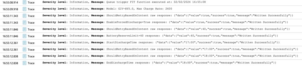

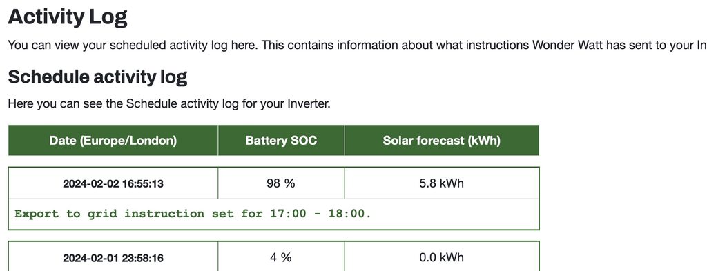

              Logs did say...
              But at 17:10 it wasn't exporting.
              Perhaps set it up too late?
                Gazzagreen Instructions were successfully sent.
                Can you show the Giv logs? Did another cmd get sent after that once it was discharging?
