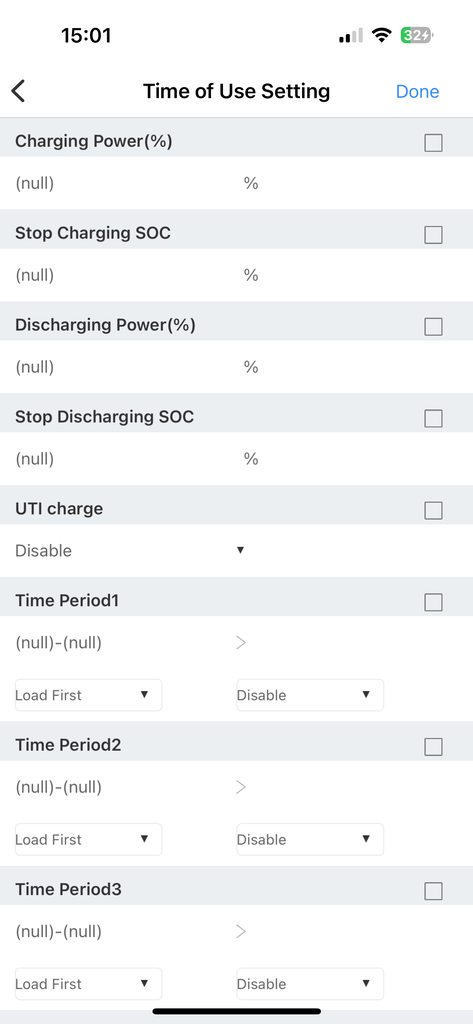

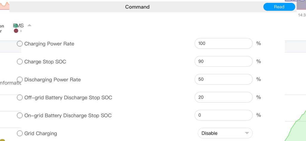

in doing the check it appears the Battery Reserve % Limit is set to the value in the Timed Charge setting. (Which is disabled) Charge to %. Is this a complication as mine is an AC3?
