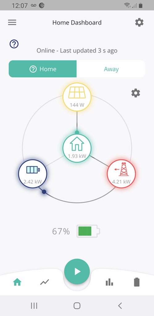

admin Where on the Giv app do you see the quick Pause and Play buttons?
Big round green button at the bottom.

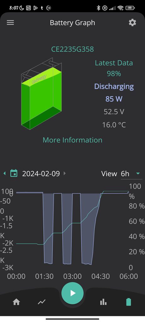

      I can report that last night I used hold from 12am till 6am with a few charging slots in between. The first hold between 48 and 51w dribbled through, 0-3w with the other holds
      admin Seems to be better. Last nights results...

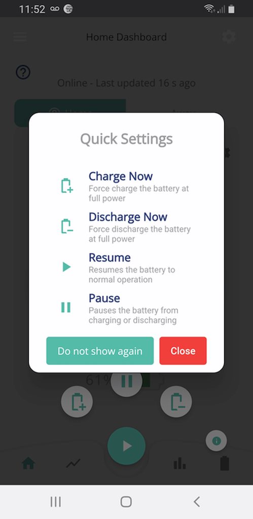

          admin it's effectively the same as using the Pause button on the Giv app
          The app pause button pauses charging and discharging but for the WW hold feature, you just want to pause discharging so you could just change the discharge settings and leave the charge settings alone.

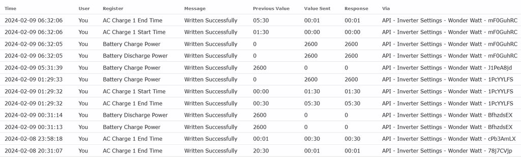

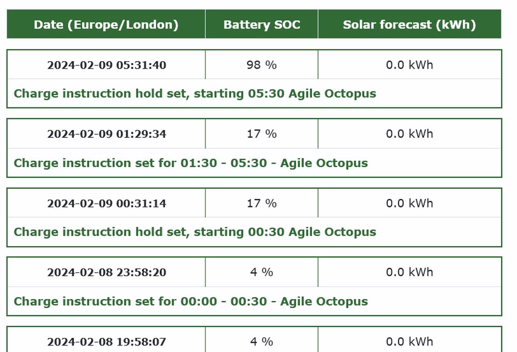

                  Last night breakdown...
                  Agile Charge Window is from 00:00 to 06:30
                  Selected slots are:-
                  First slot at 00:00 all OK.
                  First hold at 00:30 both charge and discharge set to zero
                  Next charge at 01:30 Charge is restored to 2600 but discharge remains at zero.
                  Next hold at 02:30 - Nothing received by inverter
                  Next charge at 03:00 no change to charge or discharge values
                  Next hold at 04:00 charge set to zero
                  Next charge at 05:30 charge resotored to 2600
                  Next hold at 06:00 charge set to zero
                  Window ends 06:30 - nothing in WW activity log but inverter has this
                  Battery charge and discharge both restored.
                    johalareewi Thanks for the detailed breakdown, you can see the values that were sent but weren’t changed, by toggling one of the sliders at the bottom of the Giv log.
                    All in all, went OK then? Note that the latest release does not reduce charge power in a charge hold slot anymore.

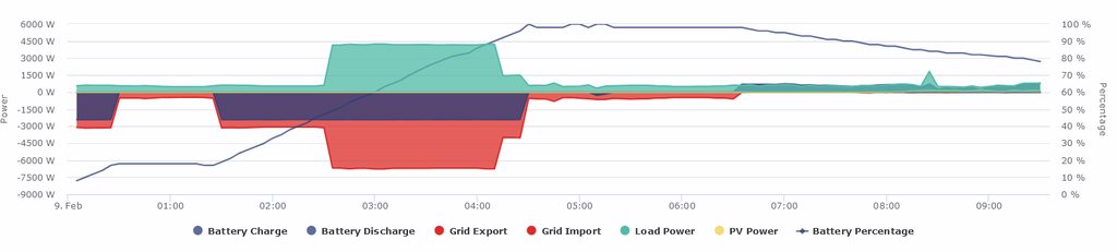

                      admin Simple one last night.
                      GE Inverter log
                      Looks cleaner just using the Battery Discharge Power setting.
