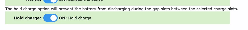

    admin Its just that on the screen it says it prevents discharge.
    Although HOLD implies no charge or discharge.
    It is also interesting that the HOLD instruction is sent at the start of the first hold slot but is not released until the end of the charge window (see my inverter log). I would expect the hold to removed at the end of each hold slot block.
