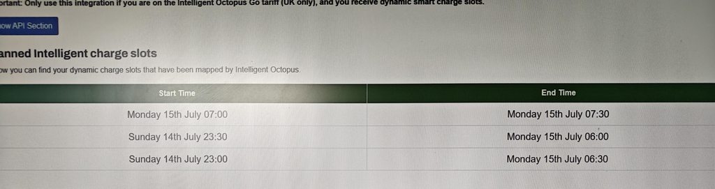

Have a minor issue with last night's charging.....
Smart charging from Octopus 23:00-05:30 and 05:30-06:00
WW picked up the slots and initially set 23:00-06:00, but subsequently overwrote with 23:30-05:30
As it turns out, the EV had finished charging at 05:15 anyway, so didn't cause an issue with battery drain, but it would have, had the Octopus EV charge continued.
Could you have a look at this please?
As a sidenote, is there a reason the charge commands are not sent until after the charge period is scheduled to start?

admin Have you fixed this? I got it do the same thing again. This time I plugged the car in the evening before 23.30 and got slots in the night slot plus up to 6.30 in the morning and then 7.00-7.30. I got 23.30-6.30 in WW at 23.32 and then 4.30-6.30 at 4.32 but what happened is that between 5.30 and 6.30 the car was charged by the battery which drained it completely for this hour. Then 7-7.30 worked fine.
angellevski Thanks for the info, yeah, we have put a fix in for this, it looks like thereโs still a scenario where a mapped slot can fall within an already started wider slot that should be ignored.
Looks like without the redundant 4:30 instruction, this would have worked fine, right?
admin I guess so yes
