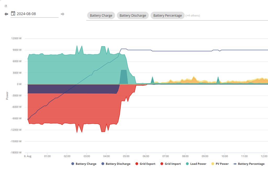

This already happens, unless I am misunderstanding you.
When you untick 'Hold charge', your battery will be charged to the level you set and kept that way, no discharge will happen when your battery is charging, so house load will be met by the 7p IOG grid rate.
At the end of the charge IOG slot, normal service resumes and your battery will be used to feed house load.
If this this not what you are experiencing, could you please detail your findings? Thanks!
