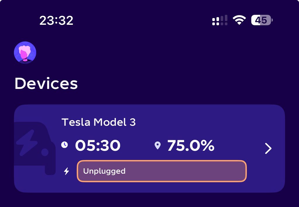

                          admin apologies for the delay in responding. Wanted to make sure I'd tested this properly before coming back.
                          The slot end time 00/30 works perfectly. I've had numerous goes at this, unplugging just after the half hour and each time the Giv charging has ran to the expected pointπŸ˜€.....
                          ...... as long as the EV is physically unplugged and we get similar to this in the Octopus app, saying unplugged:
                          I presume at this point the Octopus API despatches a signal and this is what WW is reacting to?
