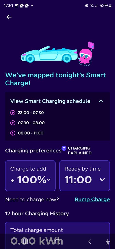

      I've configured the IO schedule and it's got updated with tonight's Smart Charge of the home battery between 23:30 and 05:30. I've just tried plugging my EV in and Octopus have mapped Charge slots between 23:00 and 07:00, then 07:00 to 11:00 tomorrow. Should any of this information be appearing in the WW schedule, as it isn't there?
        J1m Do you see anything in your Octopus Intelligent section in WW under Planned Intelligent charge slots?
        • J1m replied to this.
          admin Yes, tonight's home battery charge is showing. User ID is neat-permission if needed..

              admin So the charging slots don't appear on that page? Thanks for clarifying..

                    admin That's the problem though, only the home battery charge is showing in that section?
                    @J1m These are my screenshots from WW and IOG for tonight. The EV and the AIO will both charge.
                      JayC Yes mine's the same except the Octopus window shows charging between 11p.m and 11a.m tomorrow...
                      • JayC replied to this.
                        J1m What is you 'Ready by' time set to? (as is you look to have 7p electricity for 12 hours straight... with virtually zero possibility of WW being wrong as they are taking the read from Octo's API).
                          JayC It is set for 11a.m so the Octopus slots do match...
                            J1m My opinion is that you are all good. Because there are no gaps (consecutive) the slot is showing as just one in WW: another efficiency: why Octo lists them as many who knows.
