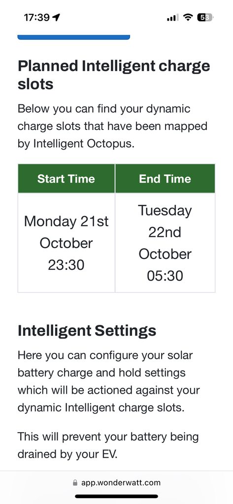

          I've configured the IO schedule and it's got updated with tonight's Smart Charge of the home battery between 23:30 and 05:30. I've just tried plugging my EV in and Octopus have mapped Charge slots between 23:00 and 07:00, then 07:00 to 11:00 tomorrow. Should any of this information be appearing in the WW schedule, as it isn't there?
            J1m Do you see anything in your Octopus Intelligent section in WW under Planned Intelligent charge slots?
            • J1m replied to this.
              admin Yes, tonight's home battery charge is showing. User ID is neat-permission if needed..

                  admin So the charging slots don't appear on that page? Thanks for clarifying..
                  • JayC replied to this.
                    J1m Hmm.... I am sure charging slots do show on that page and that I have seen them previously there.
                    Mine aren't detailed tonight but I think that is because I have not been fortunate enough to have been allocated slots outside of the 23:30-05:30 standard band (despite plugging and unplugging:-) ).
                      J1m
                      J1m Yes, tonight's home battery charge is showing.
                      They do appear under Planned Intelligent charge slots. Unless you mean something else?

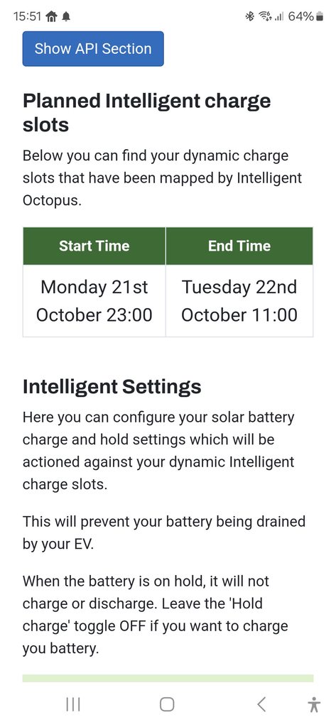

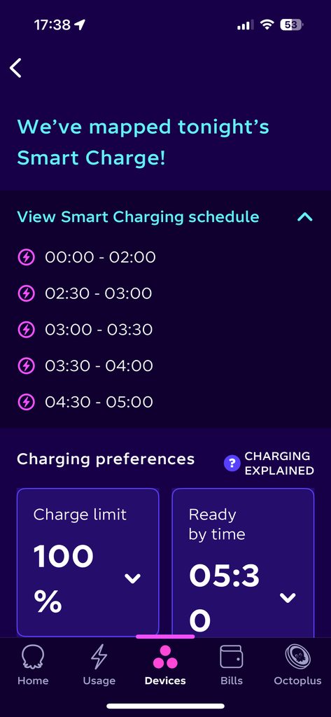

                        admin That's the problem though, only the home battery charge is showing in that section?
                        @J1m These are my screenshots from WW and IOG for tonight. The EV and the AIO will both charge.
