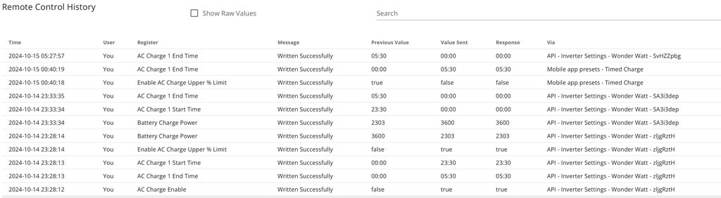

    I've just had the 2nd night in a row when the battery hasn't charged. Despite activity log saying it was going to charge to 100%. I do have an overnight schedule created, but it's disabled.
    Wattid:recent-cake

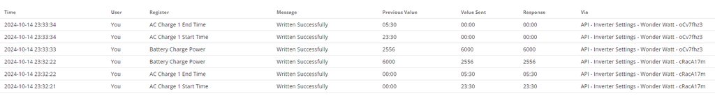

    Here is my remote inverter details… as you can see I had to set charging in the portal last night.
    Advise on what timers to change incase they re clashing? Or should I just turn off schedule charging?

        Midville Yeah looks like your problem is of a different nature. Instructions are correctly sent and received, but it looks like your inverter just isn't actioning them for some reason.
          Gazzagreen That doesn't seem to be an issue in all fairness for you, as we'd expect a different error. But yeah, let us know what happens tonight.
          Looking at the Remote History for last night, it seems that WonderWatt setup a charge schedule correctly at 23:32:22, but then cleared it at 23:33:34.
            PeteC Yep - this was fixed in Release 813. We fixed an issue in 809 where you would plug in your car, then unplug, and the battery would keep charging. This inadvertently caused a problem for the default IOG slot/window which has now been rectified.
